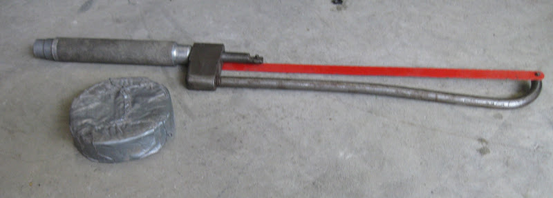

Here's a hacksaw I made in Grade 9 MetalWork - 32 years go!!! It takes 10inch blades, as you can see the 12inch is too long!
The dolly is made from lead, melted inot a tin can for me by an old bodyman I worked with at my Dads shop. It's used for pick work. I've wrapped it in duct tape to make it even softer, owing to metal becoming thinner and softer over time.
