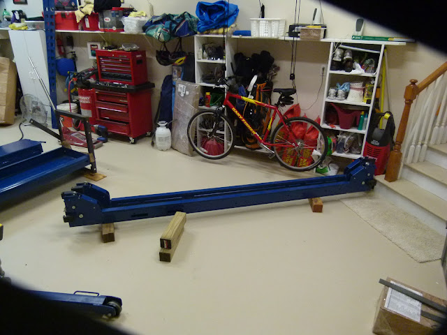

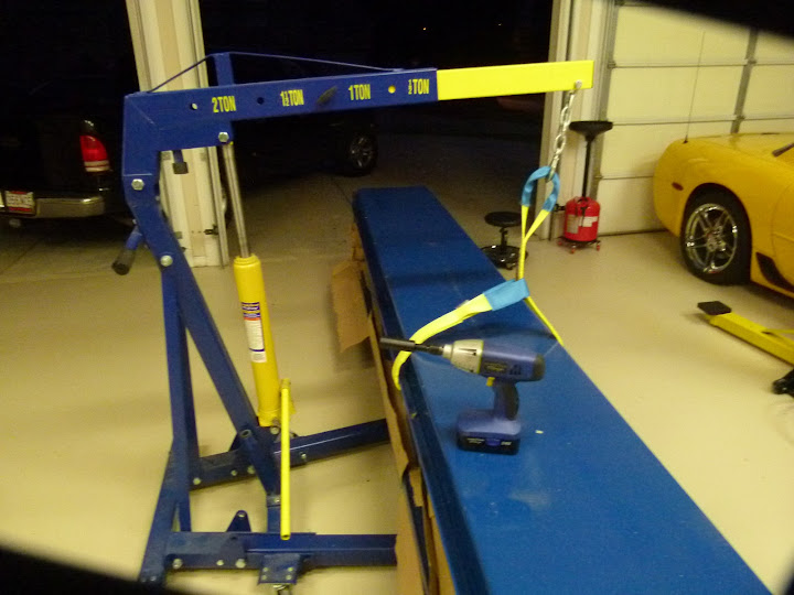

Unpacking
Wow, these things are packed!!!!! I would recommend getting the lift delivered at least a day before you want to begin work so you can take the time to unpack the pieces before you are trying to assemble. I wanted to make sure the guys helping me were just there for the "big" work so I wanted all the pieces unloaded and ready to go. So I spent a couple hours in the evening after work unpacking everything. This included two trip to the recycle center down the road with tons of cardboard!
The lift is well packaged!
Heavy pieces so you need a hoist or several people
Of course even for the unpacking job your are going to need what ever tools/people you are planning to use for the heavy items. I really can't imagine doing this without a engine hoist. I borrowed one from a race buddy that I didn't' need to return immediately. It made the job so much easier. Another thing I used a bunch of was wood blocks to sit pieces on, since the pieces are heavy and you are likely to want to get a hoist under them, have a bunch of small 2x4 or 4x4 blocks to set the runways and cross pieces onto so you can get under them with your hoist. The posts themselves are fairly manageable by hand if your fairly healthy, if you have a bad back maybe get some help. Of course you should take inventory of the parts to make sure you're not missing anything before you jump in.
All unpacked

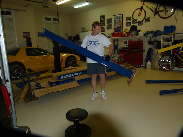

With you position mapped out in the space the first thing to do is assemble the front and back sets of post with the cross pieces. Make sure you remember that the one post with the brackets for the power unit can only go into two positions. My manual said to lift the cross piece onto the post, but me and my crew said that seemed crazy and we laid the cross piece on two jacking ramps with the ends clear and just slide the posts onto the runner, and stood the entire assembly up. Pretty simple, no nuts, bolts, or clips, just slides into place.
Assembly of post and cross piece
Double check our distances
Next the lock ladder pieces drop into place, pretty easy. We got a little wrapped around the axle hear double checking that they were in the right place based on some language in the manual. For the most part they go right into the slot in the plastic runner pieces and drop into place. Just run the bolts down on the threaded end and pull off the top nut.
Now the top plates go on, pretty simple. The small 10mm bolts are pretty long so pull out the power or air tools if you have them instead of doing this by hand. We installed the top nuts to all the lock ladders and threaded them on to the same level we figured this would get everything about even, and it did. With that all in place you can lift the cross piece and the locking mechanism will engage. We lifted them just to engage and then double checked according to the images in the manual that things appeared to be done correctly.
Now the fun stuff, time to put on one of the big runways, the one with the hydraulic ram goes on first. Our manual noted several steps to install the ram, but it was already done so we could just load it up! This is where the lifting comes in and navigating the piece into place, just take you time and get it lined up as best you can. The fit of the runway pieces is tight and you might encounter some issue with the piece sitting flush onto the cross pieces due to welds. We tried several things to line up the holes, including a little hammering but the best was to use a 3/8" socket extension in the holes as a pry bar to move the pieces and then my secret weapon, a bar clamp! The bar clamp was the way to go, it pulled the pieces together so we could get the bolts to lineup. Then we went onto the other side, pretty much the same drill. There are two positions on this model and I went with the outer most position.

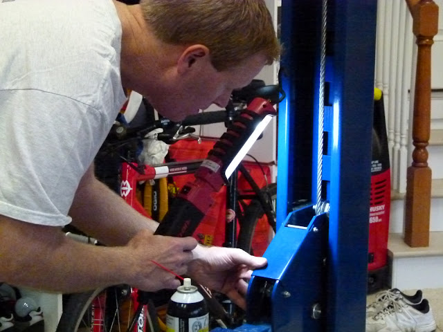

With the basic structure assembled it is not on to cables and components. The cables are all prebuilt and each is labeled to be in a specific location, this takes all the guess work out of assembly. One other thing before getting the lift I was wondering about was how would I be "securing" the cable ends? These cables are all pre made and have industrial type fittings on the end so you do nothing more than run the cable and secure with a hex nut, no cable splicing, no cable clamps to make you wonder if you have done thing properly when you park a car under it! The pulleys are easy to install, but it is best to have all the cable run first then push the pulley into place and then push through the axle piece as space is limited. We ran the cables and followed instruction to thread the the nut on at least an inch, we preset these about equal on all 4 but you will have to go back and adjust.
Mounted the power unit, one thing hear is make sure you get the vibration pad on the bracket and also have the bracket for the plastic tube to install at that time. All the fittings are easy at this point, both hydraulic and return air lines. Just pay attention to the direction the lines need to run and point the fitting that direction. Also pay attention to where the cables are and where the brackets are to run the lines on the underside of the runways, they are there for a reason.
The air lines for the air lock system is super easy, just make clean straight cuts and the fitting just push together and hold nicely. I would try to fit these carefully and not leave a bunch of slack, I didn't want them to be flopping around and get caught on something.
At this point I filled up the reservoir with fluid and was ready to give it that first lift! After the slack was pulled from the cables up it goes. I just allowed the lift to go through some cycles of up and down to settle the cables in places, just understand with no weight the lift goes down slowly, it will go down faster with the car on it. Now I turned my attention to adjustments, as the lift is raised you can listen to the lock clicking over the safety stop positions, and if your adjustments on each post are way off you can hear the difference in timing as it goes up, some posts are rising early than others. Also you might think it is above a setting and then allow the lift to lower, only to find that it only catches 3 of the 4 post, this is just an adjustment of the cable for that cable.
Noting the relative positions of the different sides to the locking ladders
I would raise the lift to an arbitrary position and us one post as a reference, I noted the height below the closest lock position, then compared that to the others, if it was lower I would tighten the cable, if it was higher I loosened that cable. I did this a few times while going up and down with the lift empty. After 2-3 time sarong you can hear the clicks are now more simultaneously and the lift won't "miss" on one post.
Making those cable adjustments

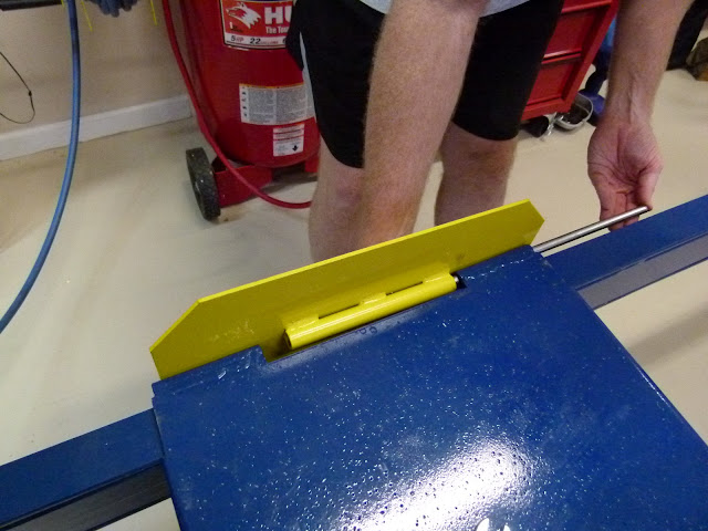

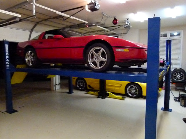

So now just put on the stops and ramps and check it all out a final time.
In my case a vette was not used as a guinea pig, but the wife's VW :)
But no issue, first lift up it goes. Don't be alarmed if the post move a bit if they are not bolted this is normal. Of course be careful to note the ceiling height and always remember you need a few inches above any stop to get the lift up and then lower it. So don't think you can put the lift and it's load up right against your upper limit.
So here are a few looks at the finished lift.

Based on this picture, is there a specific reason why the runways are not centered or the left runway is not all the way to the left?
Great write up.... thanks,
jdub
D
Dolfan
May 21, 2010
465
Greater Atlanta
jdub
Jdub, yes there is a reason. This model allows the runways to be configured at two different widths depending on what you will be parking on them. Corvettes are surprisingly wide cars and so I set up the lift with the right side runway on the outer position.
Later, like 2-3 days later I actually moved it back to the narrow setting and that leaves me about 2-3" of play to put my C5 corvette on the lift. The cool thing about repositioning the runway is you just need to remove the 4 bolts and move the runway and bolt it back in. It doesn't affect the pulleys and cables.
jdub63
Jan 28, 2008
232
Azle, Texas
Dolfan, Just to clarify, in your picture the runways are configured to their widest setting and you moved the right runway inward for the narrow setting. So in the narrow setting the runways are both equal distances from the columns? And, in your configuration (with the control and pump) the left runway is not adjustable?
D
Dolfan
May 21, 2010
465
Greater Atlanta
You got it! This picture was taken before I moved it back to the narrow settings.

OK, well I worked with the Bendpak team on the bridge jack, got a different set of runners that will drop the unit down lower, to make it better for the corvettes and other low cars.
The change was real easy, I just dropped the lift with jackstands under the bridge jack and replace the two end pieces Bendpak sent me. Maybe a 15 minute job tops!
Now the bridge jack sits nice and low, not going to hit it even with these low cars.
And then I hooked up the airline to give the unit a test.
More to Come.......
