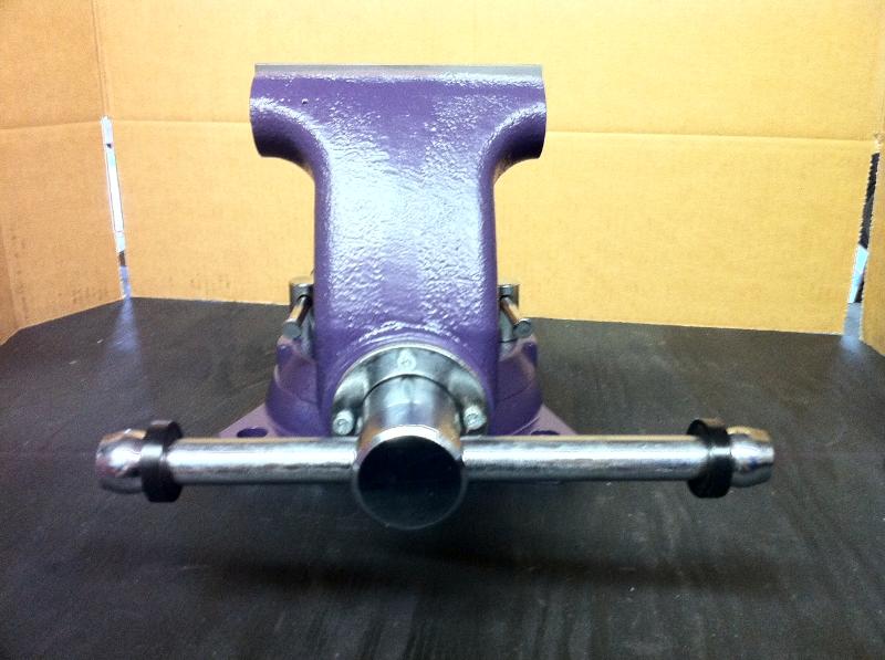

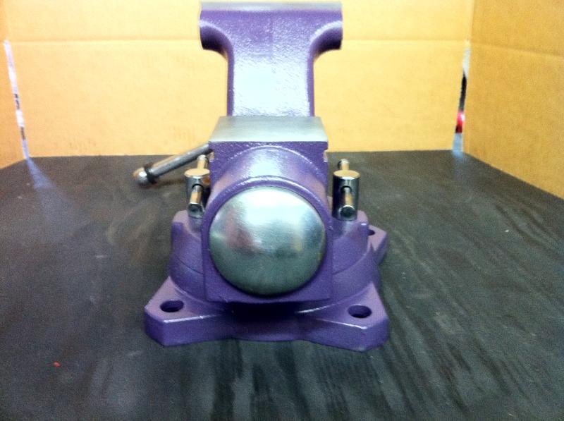

It's done!
See the old rusty **** here:
http://www.garagejournal.com/forum/showthread.php?t=123880
And the finished product:
Used Rustoleum self-etching primer and Dupli-Color DE1640 "Plum Purple" Engine Enamel.
Turned out reasonably decent for the first time I've ever actually painted anything properly.

Great restoration. Those Chinese Wiltons are rated at 60,000 psi..

very nice work did you remove the screw assembly and end cap, or leave those in tact? I'm interested to know the condition of yours, i.e. inside the "bullet".

Wow that turned out beautiful. I love the new color compared to the red. Very nice restoration.

my thoughts are that (FUNCTIONALY) buying the craftsman pro vise is alot like finding a used 1745 in good working condition, with new jaws and bad surface paint, for $100. Of course, that is, if you can accept that this vise is a Chinese copy of an imported Wilton :D. make no mistake -- this is not U.S. iron; its just a good impersonation. Anyway, I'm still in the process of becoming "one" with mine, but so far the form, fitment, and function are all very good -- only the surface is substandard.
buyers of this one will probably want to restore the finish within a few short years because there is no primer under that red paint and it shows signs of early failure right out of the box (at least mine did). just inspect closely and you will immediately see this. other points of wisdom I have found here and for myself:
1. take off the jaws and apply anti-sieze to the screw threads. I can't even get mine off with a conventional philips screwdriver and elbow greese... so this step is pretty important
2. take off the dynamic jaw and lead screw (just unscrew and it will fall off) and shine a flashlight into the "bullet". look for dry surfaces and rust, esp on the outer surface of the internal screw assembly (what the lead screw goes into).
3. at purchase time, check out the play/wobble in the lead screw where it mates up to the dynamic jaw casting. the first copy I inspected at Sears had too much slop in it, so I picked a different one to purchase.
4. use it for a while until the paint really starts to peel, and then restore it. then you will have the closest thing to a $400 vise, for $150 tops, including restoration materials. Well, it won't be a U.S. Wilton but it will be better than a Chinese copy of an imported Wilton! Thanks kythri for the example and inspiration!
5. watch sears sales until the price drops below $100. Lately, the price has jumped around between $130, $107, and $101 and then suddenly on 1/8 it appeared at $99. In addition, I found a generic 5% discount coupon for on-line purchases and selected in-store pickup, droping the price to $94.

Internals alert on the Craftsman pro vise: I just did a full dis-assembly, clean, and lube on mine, and discovered insufficient lube and chips "in the bullet". I'd encourage all craftsman pro owners to do this.
How old is yours?
I bought mine last January 2012, when the Sale price went down to $99 and $5 coupon was still active lol :D
one could argue that chips in the bullet won't hurt anything, and would just get pushed around by the dynamic jaw. That could be, but I decided not to take the risk. I was astonished to find all those chips in there, and that the mfg process made no attempt to clean them up. But this is to be expected when 90 seconds of mfg time translates into a few pennies saved on each vise. Craftsman probably contracted with the mfg for a certain number of vises at a certain price, and that price still leaves enough profit on the table for the manufacturer, the shipper, and Craftsman themselves, considering all of the distribution logistics, stocking etc. ...
