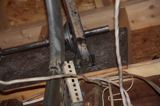

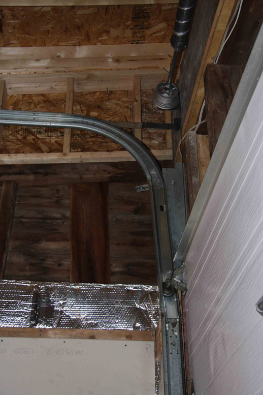

Finally, here's some updates on my garage door. I made my homeworks and come out with something that's now working properly. I should have done this at first, but while I don't usually try to save some time that way, I did on this one.
Here's my door, a 10x10 Garaga door now with custom high lift rails I've done. :)

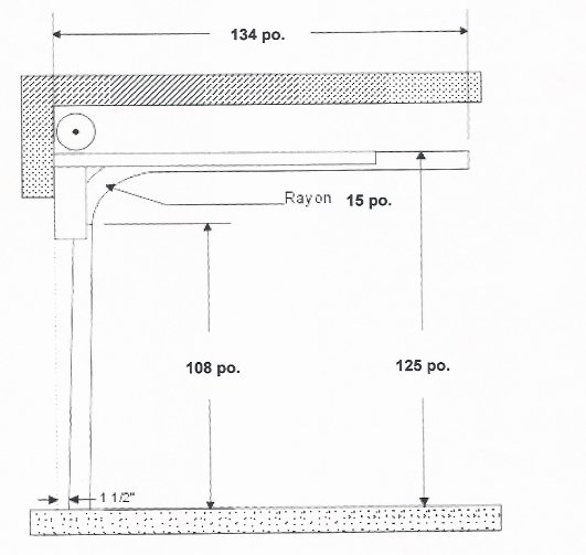

I did some plans before and after high lift rails : (Celling height isn't correct on thoses plans)
Before :
After :
Actual door with high lift :

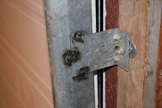

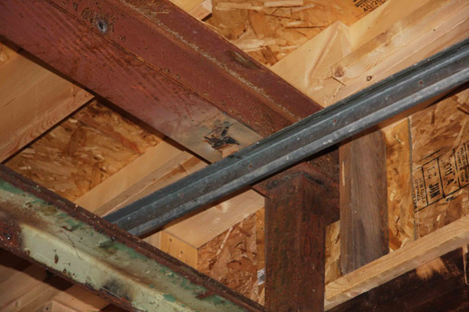

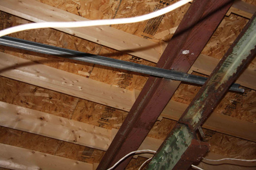

Rails :

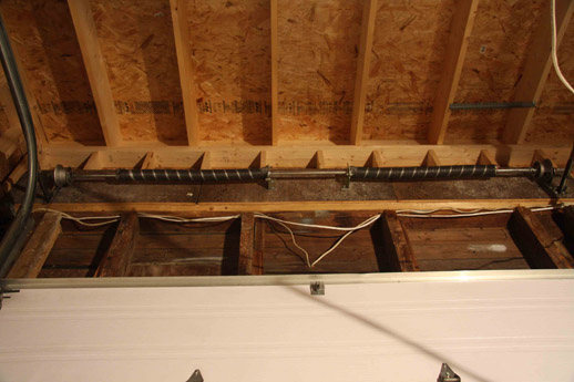

Springs, Drums and shaft :
