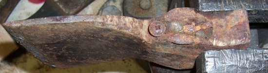

I picked up yet another Hewing style hatchet over the weekend. I get these almost anytime I can get them for next to nothing, and this was really next to nothing!
It had the handle, but it was VERY loose on it and I could see one screw in there at a glance. I wasn't sure the handle was even worth saving, but the screws (there were two of them) came out easy and then the steel wedge also came out as it was hanging out enough to get a hold of it with the vise. done!
As loose as the handle was, I still needed to drive it out with a 1/4' drift punch on the more solid places of the near ruined handle. I decided to belt sand the high spots just below the head and lose some of the top part that was all chewed up. that would get the head down to "good" wood, the rest of the handle was in decent shape despite being very old.
The part of the handle in the head had never had a wooden wedge installed, nor had the handle been cut for one! :wtf: So I cut a slot in the handle, and made a wood wedge for it. A note, I've found that hitting the sides of a wood wedge on a belt sander works wonders for getting it started into the slot, and the smoother sides allow it to wedge in deeper and therefore tighter.
The head got an overnight bath in the E tank and came out pretty good, except for the peened top edges of the haft hole where a PO had pounded on it to "get it on the handle tighter!" (I guess they never got the concept of inertia, where all you have to do is pound straight down holding the offending handle on some concrete or a big rock and the head will drive itself back on...), so I used a high speed burr to remove the inside peening so it would not interfere with the handle installation.
Once all the rust was gone, and even the steel wedge was wire wheeled off, I pounded the head back on (using inertia...) adn then wood wedged the ahndle tight. this left about 3/4" of handle stiking out the top so I belt sanded that off and hammered in the steel wedge. Rock solid! :rocker:
Why so much effort for an old hatchet? I like these hewing hatchets for a reason; These old ones, (I can't speak for the currently made versions...) have an inlaid hardened steel blade forged into the softer more durable main head for about 1/2 the thickness of the blade, and you can see it in this pic of the back side. you can see what looks like a shadow: that is the inlay, the hammer face also has a hardened face if you look that is about 5/16" thick. I actually have one of these that has part of that face chipped out and broken.
In any case, when sharpened on the opposite face the inlay is on the edge, and the softer metal is about 3/8" exposed (about 1/4" on the outer curve of the blade), and holds an edge much better than the ordinary hatchet.
I have one of these heads on a 30" long doe foot ax handle, and the added handle length give that nice edge a lot of head speed and they cut far better than a head that light has any reason to. That one has been my primary ax/hatchet for camping for over thirty years now.

Nice restore. Do you have any tips for fitting a handle to a hatchet or axe?
The first concern for me is handle selection as seen from the end of the handle, which way are the wood rings going? they should be in line with the long axis of the eye in the head, and in line with the direction of swing. Anymore it's a **** shoot what you will find in the handle bins, as they simply toss then through automated machinery.
The eye of the head should be one of two types, tapered, or a "double taper” meaning it is tightest in the middle of the head, and had room for some taper of the handle at both ends.
  • If it is of the tapered type the part of the handle that goes into the head should be restively straight for the distance of the head at least before swelling out to provide a stopping point for the head. The small and of the taper is the end you insert the handle into so that after it is wedged, the head will be captured by the taper of the wedged end.
  • If it is the double taper, type head, the part of the handle the inserts into the handle should have a slight taper also, adsn be able to fit at leas part way into the head before things start getting tight. That way once it is firmly driven on (using inertia, not a hammer...) and wedged it is wedged in both directions.
In both cases if the handle gets too tight to soon shave it down a bit so it doesn't. You can use a pocket knife, draw knife, wood rap or coarse file, or a belt sander but do it so the head goes on to the handle straight.
Make sure there is a thin saw cut the long ways down the middle of the head section of the handle, to just past center of the head for a double taper, and nearly to the bottom for a single taper head. A coarse toothed hack saw can do this, or a back saw is a good choice. Power saw blades of almost any description are too thick, with the possible exception of a band saw.
Most factory provided wood wedges are rough sawn. Sand it smooth and it will go deeper and easier into the handle. I belt sand these.
If the handle cut slot is pinched closed, you can open it a little with a wood chisel, just enough for the wedge to start. The wedge then gets hammered in TIGHT; until it won’t go anymore. Cut or belt sand the excess handle and wedge off pretty much flush, and then use one or two steel wedges across the line of the wood wedge. Drive them in flush. This can be at a slight angle. This wedges the handle in the lengthwise direction most steel wedges will have barbs on then to help keep them from backing out.
Some like to soak the head and handle in boiled linseed oil overnight. it's supposed to prevent the wood from drying out and shrinking, loosening the head. I think it is partly dependent on your local weather/humidity, and where it is stored. I have bought hammers, hatchets and axes with dried out handles, but none of the ones I have installed or bought new have dried out where I live, unless I leave then outside in the sun a lot (shovels picks and rakes way too much...)
