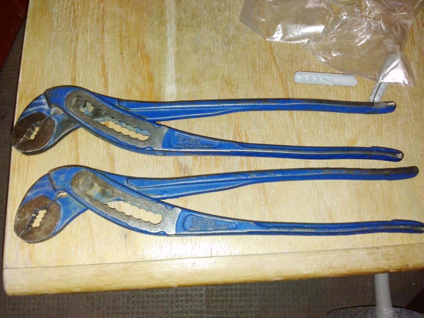

I little under a year ago I decided to check out the NWS pliers. I bought a couple different pump plier sizes and some side cutters and needle nose.
Overall their performance has been great. I heavily use the pump pliers daily. While I use them all the time I have never mistreated or abused them. I noticed lately that I have been slipping on iron pipe. I took the teeth to the wire wheel to clean out all the gunk only to find that the teeth were almost all flat.
I took some pictures to show the damages. It doesn't look like there have been any chips, but instead just collapsing of the teeth. Hopefully everyone can tell from the pictures.
Do you guys feel that this is normal? Please discuss...

That looks more like damage from a single event than wear per se. There is no wear pattern on the unaffected teeth. I'd say that is a warantee event.
archirelic
Sep 24, 2010
2,263
texas
That's what I was going to say. Doesn't look like wear over a period of time, but rather from a very specific event.

You guys are probably right. It's hard for me to tell exactly when things went wrong because they spend most their time in use. I service and clean them maybe monthly if I have the opportunity to.
The major damage looks definitely like a single event, but if you look at all the other teeth there is definitely a good amount of wear.

The Germany design pump plier puts down way more clamping force then the us design tongue and groove pump pliers. So with the same hardness the added force you can exhort will wear the teeth. So wear on the nws and knipex will happen sooner, especially if you really use the ability to really bite down. With the channel design, the piper or what ever you are holding down will slip before the teeth gives in as they do not hold as tight.
Like is like harder brake pad bite better for stopping but they also wear down rotors faster. It is a give and take.

How about that for a change.... not even used hard....(perhaps 20 times if so.....) and i was naive enough to buy an entire set of Irwin.....well, lesson learned....NWS and Knipex for the Future....
Not sue if i coincidentally purchased the one and only produced pliers with soft aluminum teeth.....:mad:
I am kind of reluctant to use the other ones :lol_hitti
The positive side is, i won't damage the bolt heads / nuts because the pliers give in before the fasteners do.... :beer:

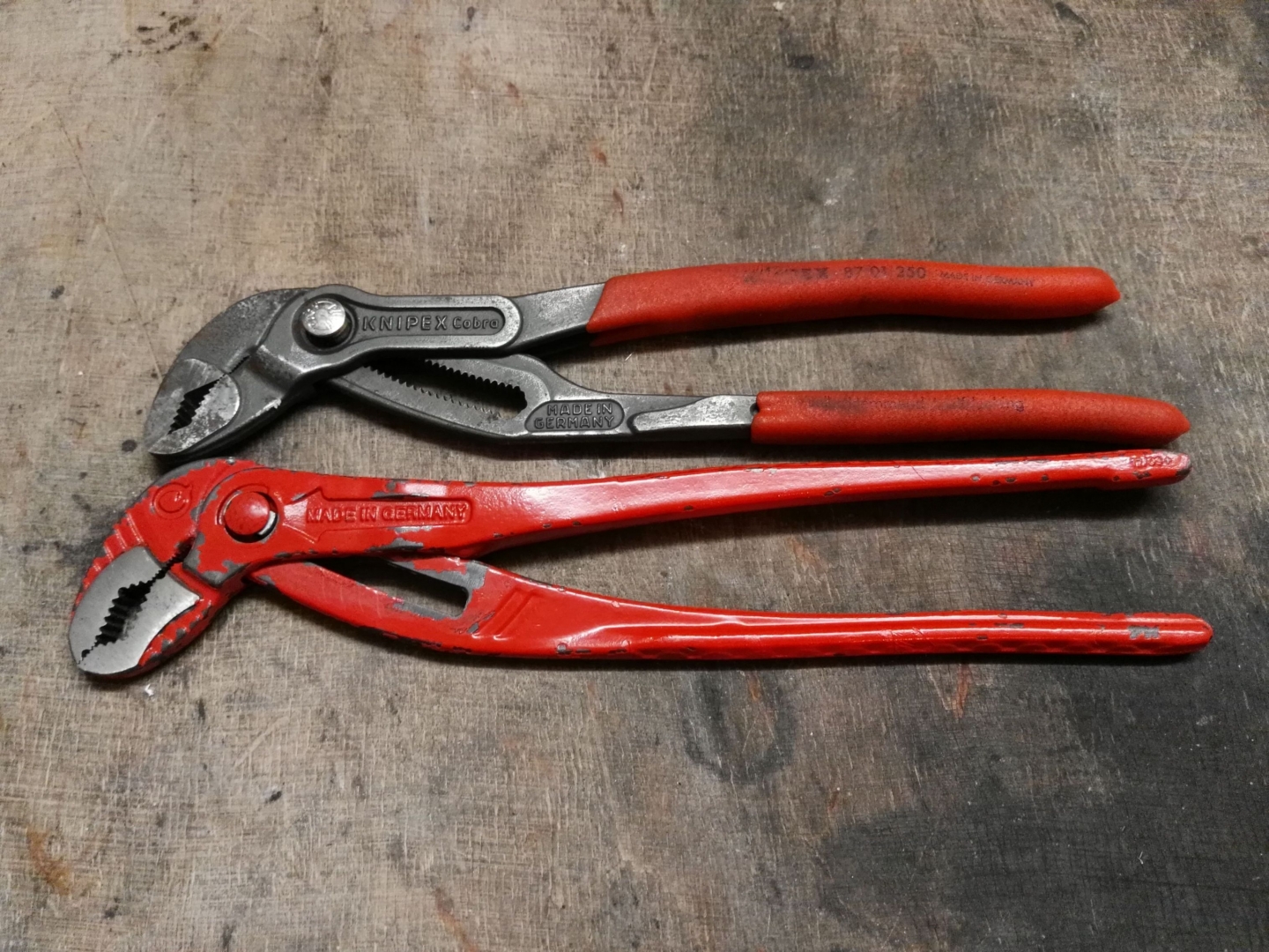

Has the quality of NWS pliers improved since this thread was started?
I love mine, haven't had any issues with their hardness or whatever. I have the satin chromed versions, first pliers I've ever had that just don't rust. I can't even get the chrome to chip. The handles are the best I've ever handled. I only have the 10" waterpump push-button "cobra" and needle nose.
The 10" cobra pliers are really lightweight compared to my 10" Knipex Pliers Wrench. The NWS weigh 12.7oz and the Knipex weighs 1 lb and 3 oz.
