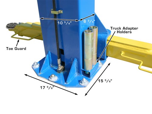

Start off by saying my shop was built on an existing slab that was poured many years ago in 3 sections....11' x 36' on either end and 12' x 36' down the middle. Where i want to put the lift, obviously, is on the 12' wide section.
So, i'm looking at the OH9000 with an overall width of 11' 3" which would leave roughly 4 1/2" - 5" from the edge of concrete to the single center anchor. The 2 other outside anchors would be roughly 5 1/2" - 6" from the edge. See this for the base plate anchor positions and scroll down a bit.... http://cdn.gregsmithequipment.com/documents/manuals/2postlifts/OH9000N.pdf
Now, would you guys see any issues with this install? What about not using the furthest outward anchor and drilling another centered between the gussets? Or 1 on the inside of each of the gussets?

If I was doing it, I'd have to cut the concrete out to a size and depth recommended by the manufacturer. I think you are too close to a seam, but call them and see what they say. I've had to call Bend-pak a couple of times to get answers to questions when I was installing mine.

My Challenger 9000# lift install instructions say not to drill mounting bolt holes any closer than 8 inches to the edge or joint in the concrete. Drilling new holes in the base plate to me doesn't seem to be a wise thing to do. You should call the manufacturer before you do any mods to the base plate bolt pattern.

There are tables in place for this exact situation. The joint between concrete slabs is considered a un supported edge. If the anchors are installed too close together, it can cause an interaction of the forces, thus reducing the holding power of the anchors. As a rule of thumb, the concrete anchor industry has established a minimum standard of ten (10) anchor diameters for spacing between anchors and five (5) anchor diameters from an unsupported edge. You will be fine as long as you have 4in concrete @ 3000 psi. I believe your lift uses 3/4in anchors. So 3/4in anchor x factor of 5= 3.75 inches from un supported edge. You have a good amount of wiggle room. If your still worried about it. A friend adapted this to work on his lift even tho it was meant for another model we just had to drill/tap 2 holes in each column base of the lift prior to installation of the post http://www.gregsmithequipment.com/Atlas-Baseplate-Extension-Kit
If the both base plates are entirely within the control joints and the manufacturer doesn't give you a spec to stay away from them, you should be fine. (The manufacturer should be able to confirm, though.)
This would definitely make the lift weak and would be dangerous. Those outboard anchors are key to the lift transferring bending loads to the slab as they tend to tip/bend inward and forward/rearward (depending on the balance of the vehicle) as cars are lifted.
Leaves me to wonder why some want to stay min 8" from an edge, liability concerns?
It all depends on how the manufacturer does their calculations and how their lift is engineered. They may need this additional space to counteract bending forces under the post legs. You should be able to call the manufacturer and confirm this spacing if they don't give it in the instructions. (Their bases could be engineered so it isn't an issue at all.)
Edges of slabs and areas adjacent to control joints can be weaker due to a curling phenomena. As the slab curs and shrinks, the control joins crack (as they are intended) and the slab edges and slabs along the joints will slightly curl up. (Just by a hair.) This is do to the top of the slab having more moisture on it as the aggregate presses down on the mass and squeezes a little bit of the excess water to the top. This causes additional shrinkage at the top of the slab, causing the curl. If the slab curls, there is a small void beneath, which can lead to more cracking under loads.
I wouldn't worry about this too much, though. The vertical loads a good lift put on a slab are no greater than what a regular vehicle puts on it sitting on its tires. Curling is more an issue for forklifts and heavy industrial equipment.

Cut it. I was in the no cut club since i work with concrete every day and before the rail came in i was sure it was safe. If the slab has rebar in it only cut 1.5in deep then bust it up with a sledge or jack hammer. This will leave your rebar intact. now just dig a hole in the dirt and pour the concrete.

The pins on the inside, forward, and rear of the posts are the most critical. Without the pins, the new slabs won't be able to resist (as well) the tipping forces the 2 post lift will create.

Did a layout of where the base will be(and if needed, the 4'x4' cutout). With the lift at standard width of 11' 5 3/8, the closest hole is 5" from edge and post will be 18" from the rail.
Drilled 3 holes to check thickness. The ones above and below the drill in picture bottomed the bit at 9 1/2" and never hit dirt! The other hole thats kinda centered a couple inches below the rail hit something that wouldn't go any further...it stopped at 6".
Drilled another hole that was between the 2 rails(as seen in older pic below...the left wheel is between the rails) and hit dirt at 6".
With the concrete being so thick, i really don't want to cut it now,lol. Think it would be ok with standard width? I could also use the narrow option of the lift which will move posts 1 1/2" in(total of 3") if need be.
