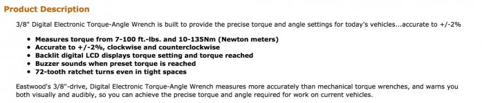

The product in the attachment claims to be iso certified.

As the review of the digital Eastwood torque angle wrenches in "Trucking" writes, value is king today in the global economy. ... "value" is seen as inferior. Not so with Eastwood's new digital electronic torque-angle wrenches. We used them side by side with other "top brand" units costing more than double and found the Eastwood wrenches to be easy to use, accurate, and solidly constructed. ...we ... ordered a 3/8-inch digital electronic torque-angle wrench (PN: 13619, $119.99). With a spec range from 7-100 lb-ft, ...the 3/8-inch torque wrench can measure as little as 7 lb-ft, ...One push of the button easily allowed us to dial in the proper angle, and it also featured an automatic shutoff timer to prevent excessive battery usage. For the price, these units most certainly fit into the value category, but with a laundry list of features, you won't be disappointed with build quality and options.
Read more: http://www.truckinweb.com/tech/1207tr_eastwood_digital_torque_angle_wrenches/

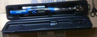

Received the Eastwood. First impression is that it is a quality tool. I have posted in my photo gallery here, images of unpacking and the tool.

Indeed, very happy with the decision. Already put to use on my motorcycle home mechanics.
