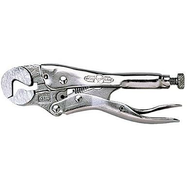

I'm no mechanic, but I had to replace a brake line on my 1998 Ford Windstar two weeks ago. Of course, I then needed to bleed the line(s) and my Snap-ons would not fit one of the front bleeders. I tried the metric sizes too, with no success.
I ended up using one of those small Vise-Grip Locking Wrenches - a trick I learned here...
When I spoke of Vise-Grips on page 1, I meant the locking wrenches, not the locking pliers. Specifically, the tiny 4LW model:
No doubt the pliers will work, but the locking wrenches will not mar the fastener the way a pair of pliers might (and probably will)...

I'm not just starting this hobby; I've been messing around with old cars since the early 1990s. That being said, I have very little time to work on anything these days, and what time I do have I would rather spend USING the car rather than dealing with broken **** that keeps it off the road.
Also, despite being in the hobby for so long, I have far less experience than a pro, obviously. I have always been able to get flare nuts off before. This is the first time I've just not been able to do it and broken the line instead.
The Knipex locking pliers and those that lbgradwell shows above are tools I don't have, but now think I should.
I don't want to just use regular vise grips if I can avoid it. Besides, since the tube broke behind the nut, it seems that gripping force on the nut was not the fatal flaw this time, but rather corrosion fusing the nut to the line and ensuring a break. Even Kroil could not save me.
