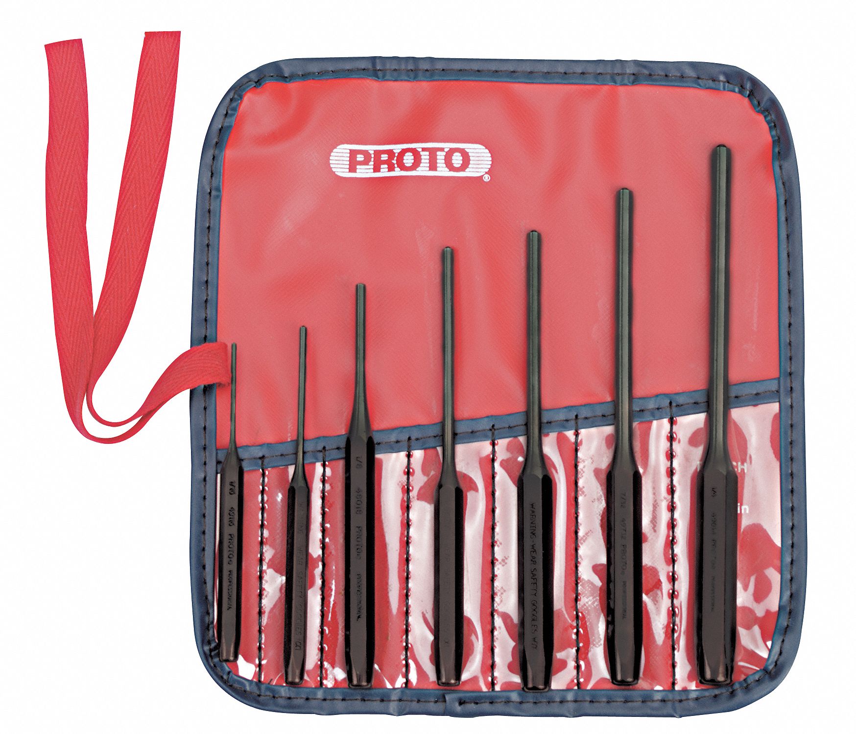

I use Proto roll pin punches, they are a must for drifting roll pins, I had been using standard drift punches for years until I got a roll pin starter punch set and roll pin punch set to assemble AR15 and AR10 rifles. After using them on several AR's and seeing how much better they work I put in for a MR for a set at work and they make life so much better, no more mushrooming a roll pin and having to drill it out.
http://www.grainger.com/Grainger/PROTO-Sizes-Included-116-6DJZ6?Pid=search
