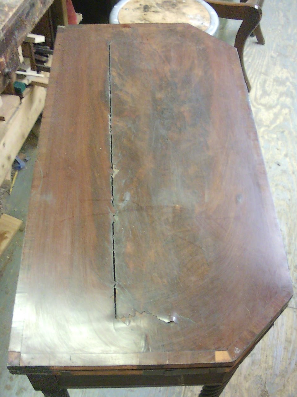

Not sure if your aware, but the wood top will want to move and shift over time. When considering how to fasten your top, think about a hole larger then your screw/bolts allowing the hardware to move within the hole. Doesnt need to be much larger.

Tarbell - no worries. I've definitely thought about movement and attachment methods. Worst case scenario I can expect the wood to move +/- 3/32". Over the entire length. This is factoring in a swing of moisture content from 1 to 21%. Individual board movement is smaller and can be used to calculated slot size for each board if one wanted to get that fancy. One would expect that wood at 11% brought indoors and sealed would only lose moisture and shrink. I'm not too worried about the piece pushing against the metal and buckling as I am shrinking and creating a gap. We don't want this to happen to my pretty (and expensive!) walnut:
For anyone interested, wood moves primarily across the grain direction. This is why you see gaps in a wooden floor tighten and expand throughout the year.
Moral of the story - yes, I'll be addressing the issue. Take a look at this tool to help anyone guess at wood movement:
http://www.woodworkerssource.com/movement.php
