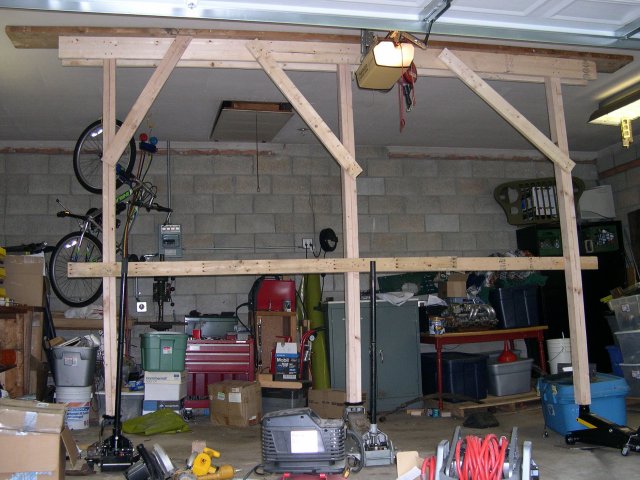

Hey, you may remember my creative ceiling correction on PBB:
Redoing the joists is still on the list.
