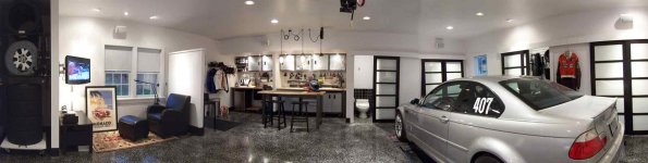

Greetings fellow garage enthusiasts,
First, thanks to all who posted before me. I've lurked for more than a year during my build project, and have learned much and been inspired with each thread I've read.
I thought I should take the time to document my build along the way, and give something back in appreciation. This is my first post.
Second, there are a variety of purposes and uses that motivate garage projects that I've seen posted here. Some are purpose built working shops, some are parking places (usually attached to the house) with family storage requirements and all kinds of space limitations, others are full on guy retreats, and others still, are museums for car collections. Some are mixtures. All are cool in their own way, but require special, very different design considerations depending on what you have to work with, and what it is that you want out of the space.
My build is a sorta' a combination of all of these things put together, but in a detached barn-like form, re-built from the ground up after razing an existing structure that no longer met my needs.
2 shots of the "rear garage":
(Edited December 7th, 2008: Inserted "non attachment" photographs for the benefit of non members/lurkers -E46M3)

The nearly finished "M house" project.
(The entire process is documented below)
I haven't really moved in yet, the neon signs aren't on the walls yet, and the final exterior landscaping, and assorted plants and trees won't be placed or completed 'till later, and...ect, ect, ect. - o.k. - it won't really ever be done... now will it - might as well post now...
(I've waited to serve up pictures till near completion so if this build isn't of interest to you, you needn't read four months of progression updates to find out.)

The Quick Specs:
Detached tandem design, 4 car garage (more on why it's a tandem later in this thread.)
• Front 2 car garage - 26' wide x 24' deep, with 2, 9'4" doors openings, interior walls clad in OSB, and will get painted white...when I get around to it eventually
• Rear 2 car garage - 31' wide x 26' deep, with 1, 20' insulated garage door separating front from rear garage space, finished drywall, insulated walls, ceiling, floor, and insulated foam exterior foundation, with in-block vermiculite insulation, and in floor radiant heat.
• Bike and toy storage wing - 11" wide x 18"4" deep, 6' exterior garage door (mandatory design requirement was to keep toy stuff storage away from the cars.) interior walls clad in OSB with a partial peg-board wall, and will also get painted
• Garden tractor and garden tool storage wing - 12' wide x 14'-4" deep, 8' exterior garage door, walls left unclad on two sides
• 5 garage doors total, Wayne Dalton brand, all with Lift-Master electric openers, key pad outside openers, all exterior doors with hinge and carriage style door pull hardware
Total Depth of structure; 51'10"
Total Visible Front Span; 37' wide
Around 1800 sq. feet of covered space in total
Other Details:
• Foundation; 6-7 course block on continuous concrete footers, with foundation drainage, and buried gutter drainage pipe running in ground to daylight, 220 feet away, downhill.
• 4000 psi concrete, 4" to 8" in depth - depending on the location, waterproof top sealed where not epoxy coated
• 806 sq feet of epoxy for rear garage floor, black base color with white and grey flecks, with anti slip additive and UGloss-AF clear coat, U Coat it brand
• In floor radiant heating, rear garage only, natural gas fired boiler, stainless steel - roof vented, 2 zone
• Bend Pack p-6-f in floor (flush mount) mid rise lift with a lifting capacity of 6,000 lbs, hydraulic lines run under floor through PVC pipes, hidden "flow diverter" in floor, covered with steel plate and epoxy-ed to match the floor
• Hot and cold running water, rear garage, natural gas fired 15 gal. hot water heater
• Bathroom, black tile up to 48", white grout (small, but required - see beer fridge requirement)
• Cable TV (with Speed Channel,) Wireless DSL internet, phone lines, 4 speaker wall mounted sound system, Sony amp, NAD preamp
• 6 Gladiator 24" wall cabinets, 2- 6' maple topped work tables, and 1- 8' maple work table with power strip, Gladiator 3/4" x 1' tongue and groove slat-wall Gear Wall systems covering 3 closet and work area walls, Gladiator 4' Gear Track sectional track for specific wall sections, 3 Gladiator rolling under table cabinets with maple tops... a bazillion hooks, bins, shelves, baskets... (all of the above purchased during "Special Today Only Sales!" at either Lowes or Sears)
• Craftsman Professional 3.5-hp Shop Compressor, 25 gallon tank, 175 psi, copper extension pipe over the lift to ceiling mounted hose reel sourced from Griot's Garage, various T valves, shut offs, quick releases, with in-line moisture control etc... (used primarily to loosen/tighten lugs and adjust tire pressures, every so often, maybe a ratchet or something - but decidedly non ******** applications)
• 3, 30 ft. retractable ceiling mounted extension cord reels
• Bissel wall mounted bag-less shop/utility vac with 30' hose, and a ton of attachments
• 3 way exterior lights, switched from main house, and 2 points in garage
• Switched outlets for neon signage - 3, 20 gauge steel neon signs (from Garage Art)
• Wall clock (Texaco) from Retro Planet, set in recessed "clock outlet," a single plug recessed outlet with cord storage in the wall.
• Recessed lighting, 3 zones, 6" and 4", both direct and eyeball fixtures, 2.5+ watts per sq. foot general lighting, all on dimmers, augmented by various task lights, pendants, and "0 degree" fluorescent mounted fixtures in both heated and unheated spaces throughout the structure.
• Exterior lighting from "Barn Light Electric" featuring 4 goose neck mounted radial wave fixtures and 2 sconces, face mounted, all with clear glass heavy dome bulb covers and wire guards, surfaces powder coated black with white reflective undersides.
• 7, Home Depot sourced, 5 light frosted glass doors, painted black, back light illuminated with switched recessed cans in storage spaces, doors mounted on sliding tracks - no doors open into the work space.
• Carpet tiles from Florz (not yet installed)
• HDTV, 1080i LCD flat screen TV mounted on a swing arm
• Beer fridge - this is of course, a mandatory.
