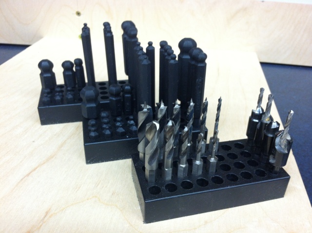

having something like that would take so much time and materials with a 3d printer. like above, i would just use a cnc router to make some.
i made this holder from HDPE plastic on my cnc router.
is that kinda like what you are thinking?

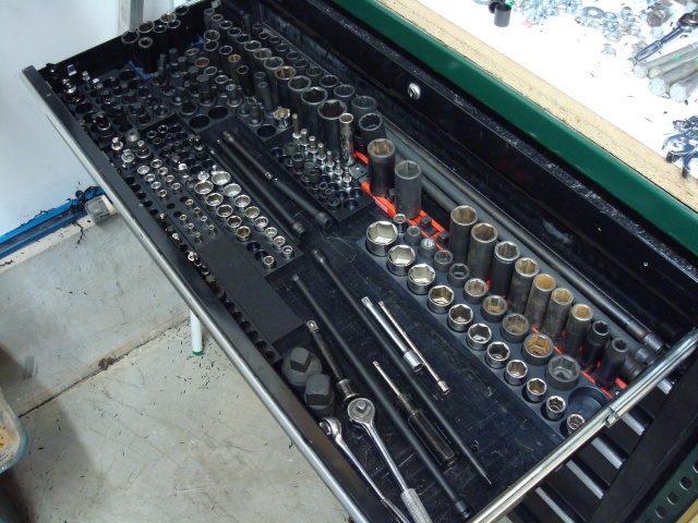

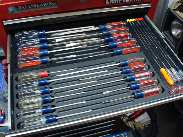

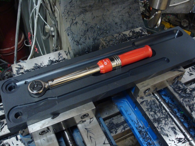

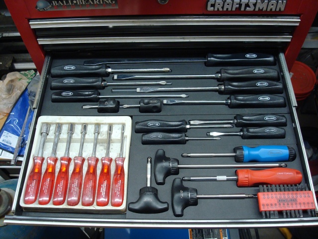

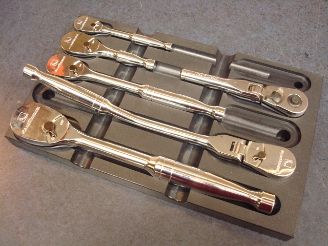

I have a 2hp knee with a centroid retrofit on it and have made many different organizational trays out of HDPE like paranoid56. Great way to get organized and as configurable as you want them to be because the design possibilities are only limited by your imagination.
Pliers Tray
Collet and End mill trays
Hex bit holders
File organization
Tap Trays
ratchet organization
Screwdriver Trays
Socket Organization
Sky's the limit. Simple trays are totally doable with a manual mill. CNC is a necessity for the more complicated stuff if you struggle with patience like me. I know some old-timers who could do things with a manual mill that makes me with a CNC look like a noob.
