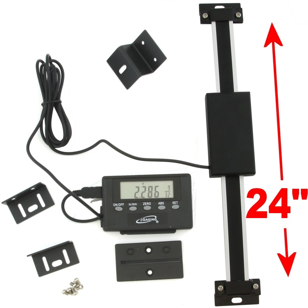

Flash forward a few years and I decide I want to put a DRO on it to make it somewhat useful... instead of a HEAVY paperweight... So researching some of the less expensive DRO I was still taken aback by the cost of the things in relation to the cost of the machine... Then Thumbing through the Grizzly catalog I spotted some "woodworking" DRO...
IGaging Branded Chinese linear scales with remote display...
they worked but the resolution on the display is not great,the Displays are small and difficult to see and are not back lit...

You can get the scales for about $124 or less shipped, even LESS if you hunt them down on E-Bay... Accu-Remote something or other scales will also work... Made by the same People's Factory number 8 in China... Only thing that won't work is the Cheap HF Calipers as their refresh rate is too slow. you can outrun them with your hand...
