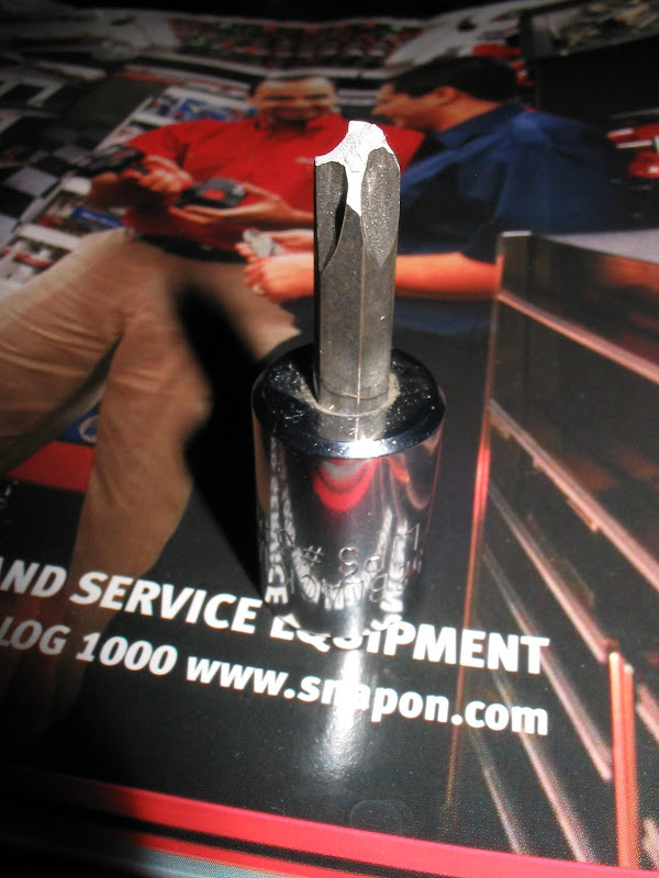

I shattered a Phillips drive bit with my 1/4" impact driver while trying to drive a screw into a dense wooden beam. I had a piece of the bit hit my cheek and even though it was a small chunk, it was still pretty scary.
Those drivers pack quite a punch and are underestimated. That's why there are impact rated bits out there....which I did eventually buy before I used the driver again.
It seems as if it's really tough to even find those impact driver rated bits in a walk-in store. But I think it's important that folks understand that regular 1/4" bits are not made to withstand the forces behind an impact driver. The metal in regular bits is strong but brittle and will shatter. The black colored impact bits (black just like impact sockets) are softer grade steel but will "deform" rather than shatter.
A broken bit may not seem interesting in terms of a broken tool for this thread but I thought it was important that I share with others my lesson learned in safety. Glasses are your friend too!

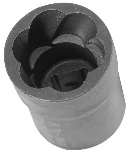

Which is when i went out and bought a lug extractor, which I had to hammer on, which ended up chewing the lug nut up really bad. !!
which type ?
like the ones in the pics or the one which looks like a fine thread ?

looks like the big one in your picture. I think im gonna try using a chisel today to destroy the bolt head.
Its a BMW so the lug nut is like a huge bolt. Once i destroy the head, the wheel will slide off but i will still need to deal with the stud part of it. Guessing ill need to drill that out, which will not be fun. Worst part is, we are doing this in the college parking lot, and we live about 3 hours from home, and only have minimal tools here.

Well, used a bolt out socket, which only chewed up the lug bolt, and twisted off. I hammered it on all the way to the base of the wheel, and it still wouldnt hold.
Next i used a chisel, and ended up messing up the lug nut pretty good, but then the chisel broke.
So, we ended up taking the car to Sears, and they drilled it out for 60 bucks. Not bad i guess, it is my roomates car, and we dont have access to any good powerful tools since we were trying to do this in the school parking lot.

While I love Bolt-Outs, the next time you might try the thread-on style of extractor made especially for lug bolts and nuts. They have a relatively fine thread pitch, pretty much a reverse pipe thread, not the coarse spiral of a Bolt-Out extractor. You may need to prep the bolt head first, but they can really get a good grip.
A plus of the external approach is that a broken extractor falls off cleanly. It seems that every car message board post that mentions a bolt extractor ends with "how do I drill out the broken tip".
