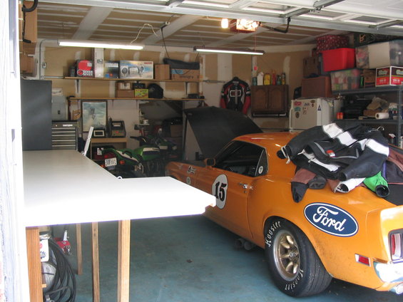

During the 2007 Writers Guild strike, I went through my completely useless junk bin of a garage and tried to get a little organized for the first time in my then 43-year-old life. Both my wife and I write for a living, so we were both out of work for the duration -- I was understandably cautious with spending money. But on the other hand, I couldn’t work -- so I had all the time in the world. I gave myself a $500 budget and attempted to re-use or re-purpose as much of the **** filling my garage as possible, while moving most of what was left to a dumpster. Every day, after a shift spent pounding the pavement on a picket line, I’d work on it. The last touch was to paint it in sort-of-early-1960s shades of green, yellow and tan.
I was pretty happy with it.

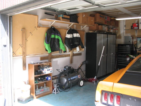

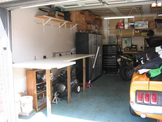

I'll take it wall by wall. In my initial clean-up of the garage, I added a fold-down table for wood projects. It had pre-drilled holes for my router table and was at the same height as the other bench in the garage so I could use it for cutting long pieces of lumber. I liked it so much that when I took up welding, I added a second, steel table for welding. Both of them fold up along the first wall of the garage so I can park my car there. But when I back the car out I can lower one or both of them for work. It’s a really handy thing to have when you’re working in such a small space.

what kind of hinges you used on your drop down benches? standard undustrial door hinges?
There are three 4-1/2" hinges on the woodworking table (that's the leaf length, basically the same length as the pin), and five 5-1/2" hinges on the steel table. All of them are screwed into the wall studs, and the woodworking bench has a support underneath the table at each hinge point so that the stress isn't on the hinge when the table's in use -- the weight is sitting on the supports. But they're standard hinges. Just big ones.

Here's another picture of the place. This one shows the color a little more accurately -- there's less of an incandescent yellow hue to it.

I like the way Jack's up swing table covers his wall of clamps and tools better than this pro system.
Now if there were a way for the support mechanisms to be hidden like on the down swing one, you'd really have something. It could be done, but the supports would come from the wall down to the top of the table surface and would be in the way.
