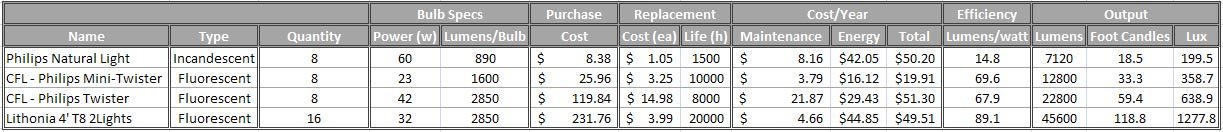

OK, going through some lighting calculations for this space... I had screw in plastic bases and 60w bulbs around, so that's what I've started using. 8 were installed, but with the understanding that they wouldn't be the permanent lighting solution. These are represented by line 1 of the table attached.
Still haven't decided what the final fix will be, though I'm leaning towards the T8's.

Switched out the Philips Natural Daylight incandescent bulbs with some Philips Daylight Mini-Twister Florescents this evening. The jury is still out on the color temperature. The Natural Daylight bulbs are in the 3800K range, really nice light. The replacement ones I installed are 5000K.
Takes about 1 min to get to full brightness, but going from ~18foot-candles up to ~33foot-candles makes a big improvement in overall light levels.
Once I actually paint the walls (bought paint this weekend) I expect a bit more reflectivity as well.
For $20 to nearly double my light levels, I figured I couldn't go wrong...

After living with the mini-twister CFL's for a little while, I really do like them. The 5000K colour temperature has worked out just fine once I got used to the change, and the light levels are certainly much improved (doubled almost). Going to call it quits on lighting upgrades for a little bit, this will tide me over. I now have about $35 into my complete lighting solution!
