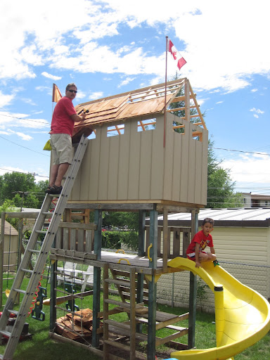

That's a shed alright!! I love that siding too: easy-peasy. I hear you on the materials cost - I built a near-replica of your shed for my kids treehouse and it was $500 in materials.
