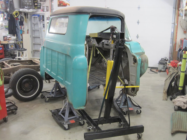

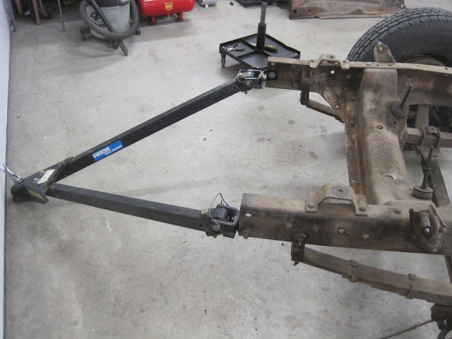

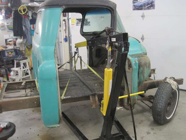

Todays action: Got the cab off the frame - with much help from the "flame wrench" - man I love that tool! Also stripped off some of the frame stuff: exhaust, gas and brake lines, wiring, along with that massive chunk of cement in the back end! Can anyone tell me if it was a factory thing - maybe added from the dealer, or was it definitely a home-made unit? It's was poured to fit around the frame and the trailer ball...
I LOVE my cherry picker too!!
Then I bolted the tow-hitch on so I can pull the frame to the Industrial Sandblasters place. I'll get it and a few of the panels blasted then coat them with POR 15.

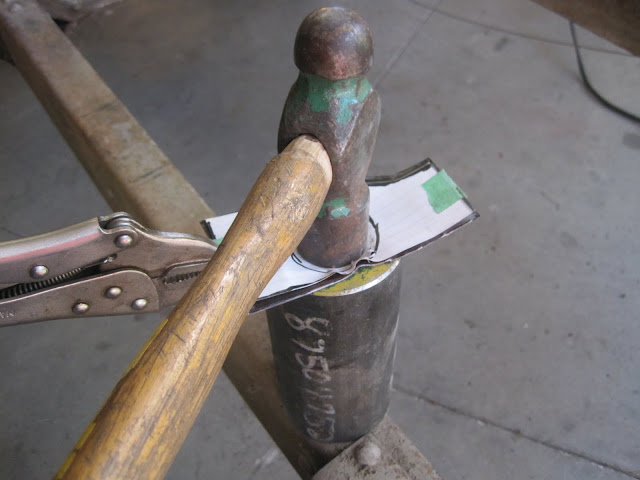

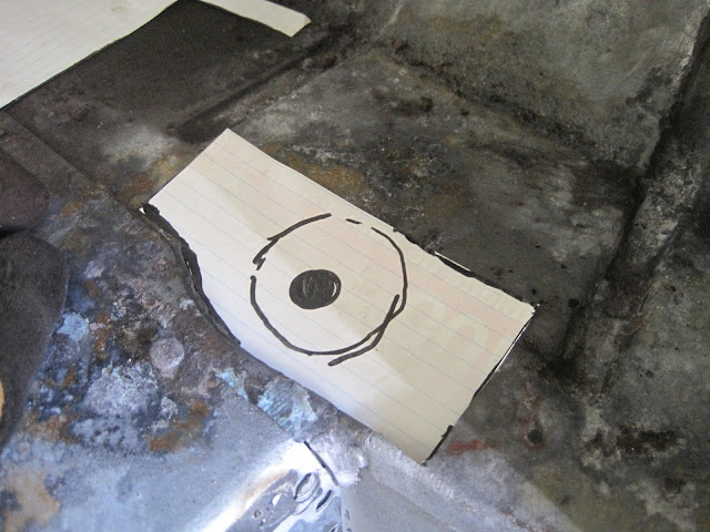

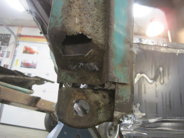

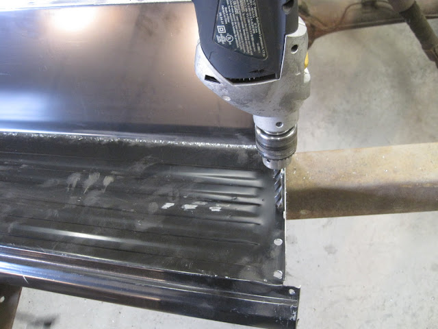

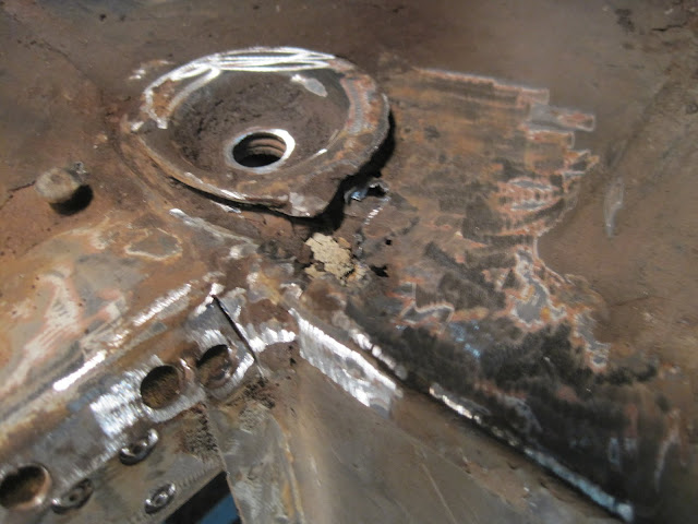

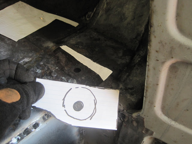

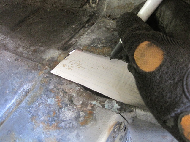

Little by liitle....

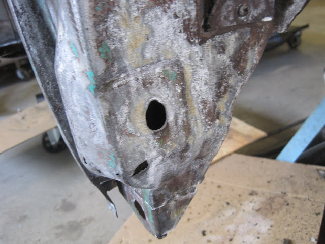

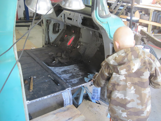

Today I prepped the frame for transport (tied the steering down, removed exhaust, etc) but - as has happened all summer - it wouldn't stop friggin' RAINING!!!! :mad: And the industrial outfits (all 3 of them) don"t blast in the rain.... I called an indoor outfit, but they're busy 'til next week. Oh well - lots of metal work to do!
The owner had already (mostly) installed the left step sill and did the hard work of removing the right side. It just required some clean-up and prep. Of course when I got into it, I found more rust - what a surprise (not...):
As always, there where some fitment issues that I had to address.
A grind here and nip there, some hammer and dolley work....

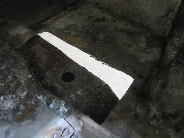

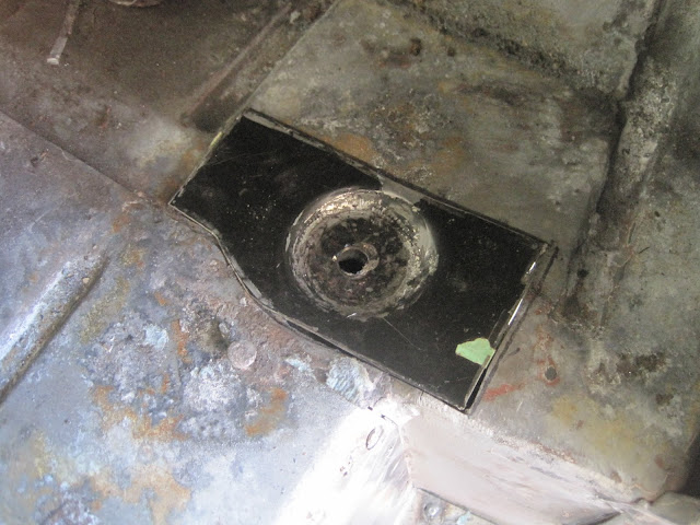

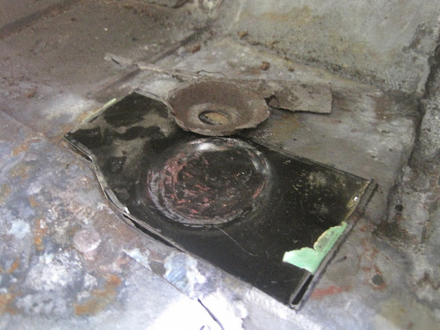

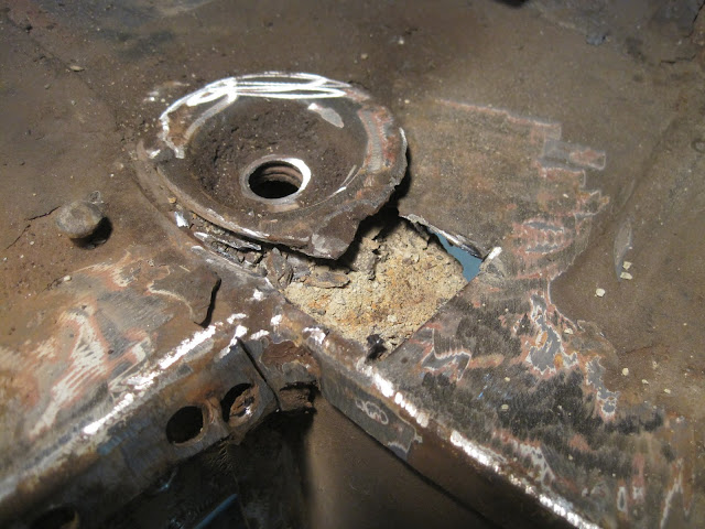

What looked like a little rust spot... at a critical spot of a cab mount, had to be properly addressed (not that any spot wouldn't be I guess!):

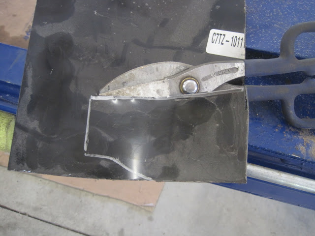

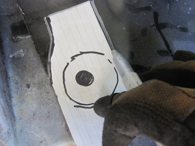

This is the extent of it. I cut around the bolt seat so I could make a template for a new piece, then I removed and cleaned it all up. Finally, I sprayed Metal Ready (a Phosphoric Acid solution fro POR15) to neutralize the rust.

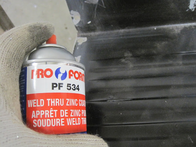

While the MetalReady was working, I prepped the new step for weld-in tomorrow. This consisted of drilling holes for spot welds, grinding away the electro-coating, sanding the areas with a scotch-brite pad, then spraying weld-through primer. I'll clean up the cab parts tomorrow and spray them too before final welding.
:beer:

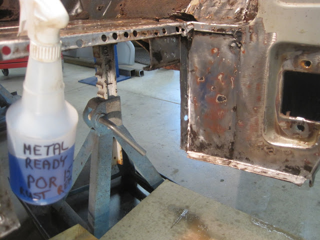

I love Sundays! In the middle of a bunch of yard and family stuff, I found time to put togther the patch for this rotted out mount.
Next time out (after a couple days at my "real job" :waah: ) I'll weld it in!
While we where out, my son helped me spray down the rust again with MetalReady:
This is what it should look like after a few applications. The phosphoric acid converts reddish-brown iron oxide (rust) to black ferric phosphate. The white is the phosphate, the black under it is the ferric phosphate, which can be ground off, leaving a "fresh" metal surface, or can be left on, which will confer more rust inhibiting properties.
bgott

Can you paint over the ferric phosphate or will it screw up the paint?
You have to remove it before primer. You can wash it off with water or a wet rag when wet, but I end up sanding it all off with the DA as I prep for primer, then I always wash the metal down with a pre-paint solvent ("Wax and Grease Remover").
