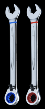

Reversible ratcheting,15 offset,anti slip open end;
I beam handle for more touch.
Blue for metric,Red for SAE.(Is it neccessory to make this color for identify metric and sae?);
The blue and red color is " Nano Anhydrous Plating",which is environmental friendly than normal electroplate;
Chrome finish or satin?
What is your idea about this set?

Zombie thread alert!
@bryant 24 You might want to start a new thread for this. The issue with resurrecting old threads is that people will respond to 12 year old posts without looking at the date and will then never reply to your question.
As for the wrenches you posted you don't give us a brand or any origin information. Based on the information you do give us I don't see any problems, but there is no way to tell how good, or reliable the ratcheting mechanism is.
